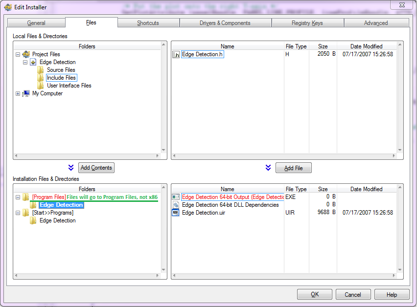

I assume that you are creating the installer in LabWindows/CVI following the similar steps:
1. Go to Build -> Configuration and set it to Release64 or Debug64
2. Go to Build -> Manage Distributions
3. Select New
4. Set 64-bit Windows Installer for the Type and Press OK.
5. Edit Installer dialog box should appear.
6. Under the Files tab you should see something like this:
In this configuration window you can set files to be installed in the specific directories (have a look at the green text on the screenshot).
I built an example installer and during the installation required files went to the Program Files directory, not Program Files (x86).
Please try following above steps and let me know how it goes.

My particular problem is the [LabVIEW] path shown in the above image. The LabVIEW folder is selected from the right click menu.
The Help describes the LabVIEW folder as:
[LabVIEW]—The directory containing the highest installed version of LabVIEW. If LabVIEW is not installed on the system, the installer uses a default directory, typically C:\Program Files\National Instruments\LabVIEW.
When I create a 32 bit distribution, the TQLP folder is installed to the most recent 32 bit version of LabVIEW on the target system as expected. But when I create a 64 bit distribution and install it on a 64 bit system with only LabVIEW 64bits installed the TQLP folder ends up in "C:\Program Files(x86)\National Instruments\LabVIEW". The installer actually creates this path as it doent exist on a 64 bit version of Windows with LabVIEW64 installed.
So, my question is how to get my TQLP folder to install to the instr.lib folder on 64 bit LabVIEW ?
