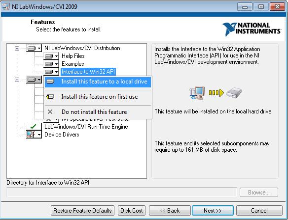

I'm using the full development system of LabWindows/CVI 2009 and do not see shell32.lib in C:\Program Files\National Instruments\CVI2009\sdk\lib\msvc.  Have I failed to install something?  I have 16 other lib files in that path.  Also, any word on if/when SHGetFolderPath and/or SHGetKnownFolderPath would be implemented in the CVI library?
Message 9 of 18
(11,929 Views)
You have to select that feature when you run the installer. You can still re-run the installer and then select that feature:
18299iD4F9D5512C85E2B7
