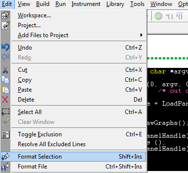

To auto-indent specified lines, select lines of text in the Source window, and select Edit»Format Selection or Right-click in the code and select Format Selection from the menu. To auto-indent an entire file, select Edit»Format File or Right-click in the code and select Format File when no code is highlighted.
Fig 3. Right-click in the source file to Format the entire file or selected lines of code.
Fig 4. Formatting can also be performed from the Edit menu.
