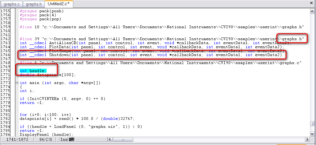

To view the output of the LabWindows/CVI preprocessor, ensure you are editing the source file of interest, and then select Options»Preprocess Source File.
This will generate a source file that is the result running the source file you are editing through the LabWindows/CVI preprocessor. With this file you can search for the line of code that caused the error and then evaluate the implementation preceding this line. Using the preprocessed source file, we can see that that the line of code that is called before int handle; is missing a semicolon. The preprocessed source file also indicates the file in which error is coming from. In this case, we see that the line of code with the missing semicolon is in graphs.h.
The preprocessed source file has given us enough information to open the file that is causing the error. This allows us to resolve the syntax error. In this example, we can open graphs.h and include a semicolon on the line of code that is causing the error to occur.
