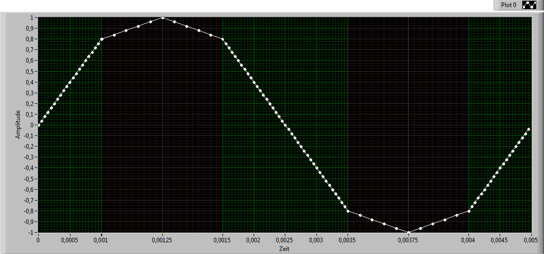

is it possible to generate an unequal scaling of the x-axis of an xy-graph?
Normally, the scaling of the axis is equal:
Is it possible, to generate an unequal scaling (see red parts)?
Why?
I want to give the user the ability to have a zoomed look of the data, without loosing the whole graph. I know, that zooming is possible with the graph palette.
Thanks a lot.
Michael

Hi Michael,
yes, that's possible with a XY graph.
Just use a different spacing between your x values…
I'm sorry, I just read your message again. No, you cannot have different scalings mixed on your x axis.
Workaround: create your own XY graph by using the 2D picture indicator and all the functions used to create 2D images…
