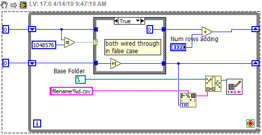

Hi, I wanted to log data more than than1048576 rows(max.numb of rows in excel), how can I do it?
I am using the write to spreadsheet
I tried adding sheet but it did not work out (using report generation toolkit)as it affects my other structures
so I was thinking to add a new log path after the first sheet of excel is full 1048576

Yes.  Limitation of Excel.  Older versions were limited to only 65536.
Do just what you said, keep track of how many rows you've created.  When your next row is going to be greater than the ~1 million limit, have it go into a case structure that creates  a new file name and discards the old.

Simple: Don't use excel. Write to a simple delimited file (or preferably to a suitable binary file) instead.
Your program knows at all times how much was written (e.g. by incrementing the counts in a shift register), so you can automatically increment the file name at regular intervals if you want to keep the files manageable.

When did I i ever say your program would stop?  Or that your program would be prompting you for new filenames?
I figured you should already know how to programmatically assign a filename without any file dialogs prompting you.  And how to build a filename such as a based file name plus a number that is inserted into it that you could increment each time you need a new file.
And as others have said, although Excel can now open files with over 1 millions rows, it can be come dog slow in trying to work with that much data.

I gave you an answer on, but apparently you didn't understand.
Here is a screen shot example.
Example_VI_BD

Excel can open simple tab delimited text files and still do all that with the imported data.
