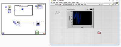

i have some trouble how i can change the plot color of my waveform using ENUM control. i have attached my attempt. Thank you

Just set the active plot to 0 and then connect the color as shown in the image. If you want to change the color of multiple graphs then you have to change the active plot according to the signal input

thank you so much it was helpful.
