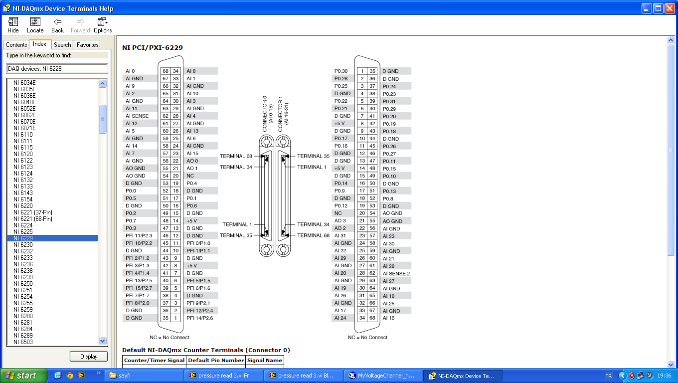

i got values between -95 and +45.Firstly i asked, what is the difference between diff and rse which one should i do?i connect acquire data-analog input-voltage-ai6

Diff = differential
Rse = referenced single ended
You should be using differential.
I asked for pin numbers, not names but you only provided a single name. No idea of you connected gnd or the second channel of a differential connection.

pin1:+
pin3:output
pin4:-

That does not make any sense. For a differential connection, you connect ai0 and ai8 - pins 1 and 2 with the usb device and the screw terminals. Did you look at the connection diagram given in MAX or the DAQ Assistant?
I connect signal to ai0.for differential connection, where am i suppose to wire power supply - in this DAQ?Could you please comment on this figure.For ex. there exist AI8 but in DAQ surface i cannot see it

In MAX i tried to look at it but is says; the connection diagram tool does not support this device

http://www.ni.com/pdf/manuals/375204a.pdf this is my device's manual.at page20-21-22 say something about you said but could you please physically tell me how to do it?

i have solved it. ai0- is round metal cylinder 🙂
