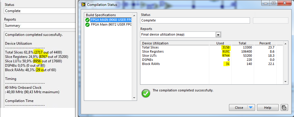

I wrote a basic program for myRIO as FPGA target. I use just a button and a led. But it takes 40 minutes to compile it and it says that it uses 44 percent of the fpga. I think it is impossible how is it possible i dont have any other code on the project.  Actually my program works correct with no problem. But it is not logical. I use sbRIO too there i have meaningfull results as device utilization

It really sounds wiered. So are you sure that no other source file components are added in the build? Can you show the Compilation Summary ?

The MyRIO uses a similar zync chip to the NI 9068 CompactRIO. See here for more info on why you're seeing this behavior: http://forums.ni.com/t5/LabVIEW/cRIO-9068-FPGA-high-device-utilization/td-p/2825138

cade for you i add a compilation summary snip. this time it takes 19 minutes. You can look at device utilization.

T-REX$ is it okay with the device utilization that i send in the previous post ?

T-REX$ what can u say about this I'm using zynq XC7Z010.
I add another picture.
I'm looking at this . page 3 and 5 can say something to us

That appears normal to me. In the other thread I linked you to, Lucian got very similar results for his simple VI. His VI was slightly more complicated than yours, so that explains why your resource utilization is a little bit lower.
Your results are on the left, his on the right.
Cheers!

T-REX$ thanks a lot to you. Everything is all right than. I often use ISE and Verilog to programm FPGA. There i have not such as this results for zynq FPGA's by device utilization.
