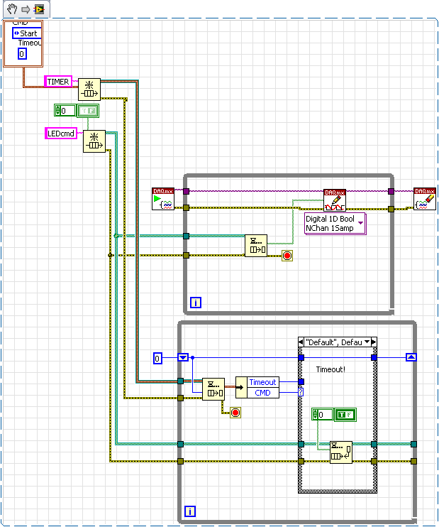

I'm looking for some advice on the best practice to structure this type of operation...
I have a main vi that allows the user to select an LED to illuminate (physical LEDs, not virtual).  This will work by the main vi calling a sub vi that is responsible for controlling the LEDs.
I want the LEDs to operate in the following method:
1. User selects LED to turn on...that LED turns on
2. LED will turn itself off (timeout) if a period of time passes (time set by user in main vi)
3. If user selects a different LED to illumininate, the previous LED will shut off, and the selected LED will turn on.  I want this to happen even if the timeout of the previous LED hasn't occured yet.
4. Timer resets
5. Rinse and repeat 🙂
Thanks! -Mike

If you are using a version of LabVIEW with event structures I would put the LED selection in one loop, the actual LED control in a parallel loop, communcating via queues or functional globals, in a "produceer/consumer" style (look at the built in LabVIEW examples). Then the vi controlling the physical LED can keep track of the timeout, etc. I don't know how you are controlling the LED's, a digital output? The actual controlling vi would probably be a state machine that has states for changing the on/off state of the LED, keeping track of the timeout for the currently on LED, etc.

Don't use the wait function.  Use the Elapsed Time function.  Put it in a loop.  Use an OR fucntion to stop the loop.  Stop the loop when either the Elapsed Time has expired OR the user presses a button that is supposed to override the timer.

Another great use for the elapsed timer function!  But you could improve the code just a bit (to add expandtion capabilities) by adding a third loop and a second queue!
I'll post a mock-up in a bit- but I'm thinking a UI loop- firing event driven commands to two consumers> an LED control (simply runs the hardware task) and a timer control loop (start timer- reset timer.  this loop would also enqueue a command for the LED control loop on a when timer expires.-  and you CAN use the TIMEOUT event wnd move the timeout value by adding the timmeout value as a component of the queue

Here's a snippet showing an example of the Timer loop and the LED loop- the UI loop is pretty straight forward but I've gotta get to work!two loop timer.png
