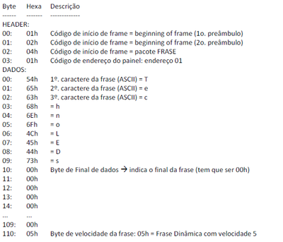

I started a new VI on LabVIEW 2021 to communicate, about tcp/ip, with a led display like a billboard as image below.
I get a communication as TCP/IP through the manufacturer software, but i didn't know what is the package i need to send, the full package.
This led display it's a simple command use, with there software (above) or bluetooth in cell phone,  but, to communicate for TCP/IP, they install a conversor, the USR-TCP232-T2 module, as image below
The image bellow, I show the simple program im LabVIEW to command this led display but the main question is: whats is the kind of package i need send to show the message or change the configuration of the display.
In attached, we can see the datasheet that manufacturer send us about this led display and the package to send, but i did'nt undestand how to do 😕
It's my first time to work with TCP/IP on LabVIEW
Something like this:

So, this is what I'm wanting to know.
I don't know how to transform this datasheet data into valid data to send via TCP/IP
I don't kwon pass of this:
To something like this:

I discovered something that help too much.
I used an emulator to receive the data from manufacturer software, to see how is the data that the software send.
The data is show bellow:
01 02 04 01 46 45 43 48 41 4D 45 4E 54 4F 00 00 00 00 00 00 00 00 00 00 00 00 00 00 00 00 00 00 00 00 00 00 00 00 00 00 00 00 00 00 00 00 00 00 00 00 00 00 00 00 00 00 00 00 00 00 00 00 00 00 00 00 00 00 00 00 00 00 00 00 00 00 00 00 00 00 00 00 00 00 00 00 00 00 00 00 00 00 00 00 00 00 00 00 00 00 00 00 00 00 00 00 00 00 00 00 00 00 00 00 07 03 06 00 00 06 06 06 00 00 00 00 00 00 00 00 00 00 00 01 FF
I need necessarily send 135 package of data. The last one (FF) is to end of the package of data.
the first four data (01 02 04 01) never will be change.
the next data, is the message i need to show on the led display following an ASCII table, e.g.:
F   E   C  H   A   M  E   N   T   O
The other data is not important for now.
After that, on LabVIEW, I created a code to concat all this data to send to TCP/IP, but this data is not equal the above, see bellow:
This string output is 4 number (4 digits), diferente of is sended from manufacturer software, that is 2 digits.
Now the question is: How can I send equal the manufacturer software?

You can create a string diagram constant, set the display to hex format, and type whatever you want in it. That single string constant would replace your entire in that gigantic Rube Goldberg case structure content!
You need to attach your VI, because we cannot tell most important things from a picture. As a first step, make sure to show the display style! To replace relevant parts with real data, just a little bit more code is needed.
Byte manipulations are a core skill of any programmer and this is a trivial scenario. You simply need to learn a little bit more.
I am not going to squint for hours to see which four bytes are different. Can you point them out?
I would recommend to have a U8 array of the correct length where you would replace elements/subsets according to the desired data, then cast it to a string before sending. Where do you calculate the checksum?

I finished this project with successfully. See below.
This first image, when you press the button, erase all message on led display:
In the second photo, we can send to the led display, de message "INFUSAO" like a HEX code, the display receive the message and show there:
I take off this part of VI code because this part is waiting a reply from the Led Display (TCP/IP read) and, with then, the VI is stopping per 20 seconds and this is not so good
