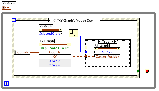

That is really odd, GerdW.  I noodled around with it myself and it doesn't work if I set the active cursor inside the subvi, but does work when I set it in the main vi.  Perhaps someone with a better understanding of vi references can give use some idea of what is going on.

Hello tst,
yes, your example is running too on my computer.
But my problem is:
How to detect the currently active cursor just from the graph properties? The user should not give the number of the active cursor before clicking in the graph, the program should detect this on its own...
For my and your understanding: I thought the active cursor is the one having the small LED of the 'move cross' in the cursor palette switched on... (Yes I know, you can switch on more than one cursor to move [and LabView should give me back the first one of the list]!)

hi tst,
I can't create the "Map Coords To XY" method for a Waveform Graph.
I tried using a the general Invoke Node from the Application palette, but in vain.
Can U pls explain to me how to create it in LV 7.1 ?

Gerd, it seems that the cursors with the green LED are reflected in the Selected Cursors property. You will of course have to select only one of them.
Partha, as I mentioned in my original post, the problem with this is that it is a private method. That means that NI put it in LV, but it can only be accessed if you put a special line in your LabVIEW.ini file. The fact that it's private means either that NI thought it wasn't ready for public use (maybe it was still buggy) or that they wanted more time before they made it public (maybe they wanted more testing or needed to complete the documentation, etc.).
After all that, to use that method for a waveform graph, you can create your waveform graph, place the invoke node in the same VI, right click the invoke node and select Link To>>Waveform Graph. Now the node will be connected to the waveform graph. Just remember that the fact that it works does not necessarily mean that it will always work.

GerdW a écrit:
...How to detect the currently active cursor just from the graph
own...
You confused the active cursor and the selected cursors nodes. The attached vi shows how to take advantage of both functions : when you click on a cursor, it becomes the selected cursor, and is used subsequently as active cursor.
