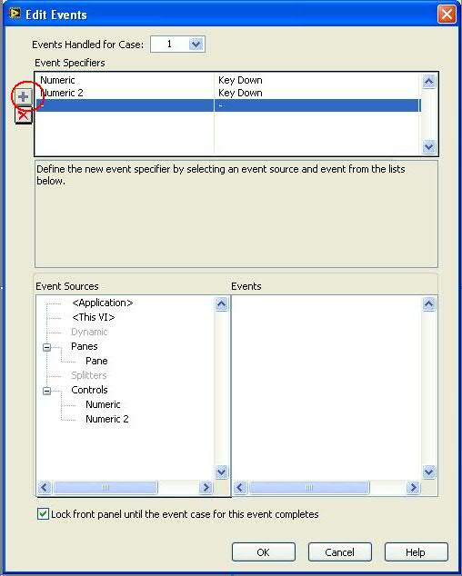

Hi Lab-Lab,
Please take a look at this screenshot. (the circled portion)
If you right click on the event you want to be running for two value changes, and edit event, you will notice this window. Please add any other event by clicking on that particular event and then clicking on the add button. Hope this helps.
