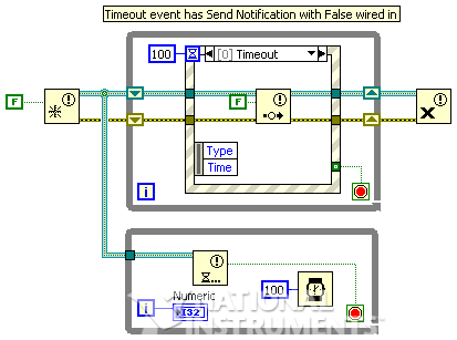

You could use a Notifier.  In the following example, I used an event structure to capture the stop button event.  When the stop button is pressed, set the notifier True.  In the Timeout case, set the notifier to False.  The timeout is needed so that the 2nd loop doesn't sit there waiting for a notifier.  It will execute at the same speed as the timeout value.
21800i4AD7160C23530C4E  This is a simplified producer-consumer architecture.

Yes the local variable will work (and I've used it) for stopping a loop from other locations.  It does have the pitfall of not being able to extend to multiple loops if it is a latching boolean.  The reason is pretty obvious if you think like a latching boolean.  "The first time I'm read I'll go back to my default" so the value gets read once and changes state back to the original so it stops one loop and one loop only.
A more robust means would be to use queues and for---- sugessted.  Look in the labview examples under queues for some great pointers on how to implement a Producer Consumer loop.  you really are speaking of issueing a "command" to control the state of an independant loop so many synchonizatio methods are good starting points.  Notifiers, Queues, or dynamic events are all possibilities for passing information into a loop (or even other sub-vis)
