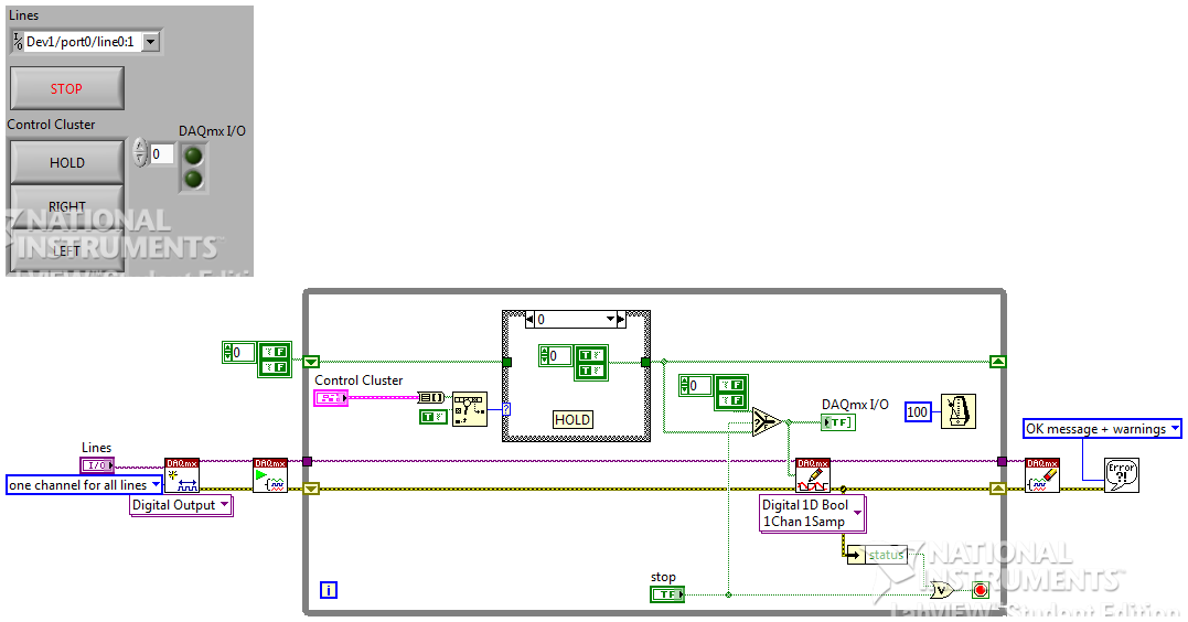

Hi
Thanks for the reply.
attach is what I'm using right now.It's very simple as I'm just sendig 5v to my circuit to switch the solenoid.but I can only switch one valve of the solenoid at a time.  I want the solenoid go ON and OFF simultaneusly as I send the 5v but it doesn't.

@Elmira wrote:
So as for my solenoid I’ll have 4 states. (both off), (left off, right on), (both on), and (left on, right off).
so let me understand what you are trying to do here...(both off), obviuosly you have not started the program. (both on), the program sarts.(left off, right on), moves the cylinder in one direction and the opposite is true for the (left on, right off)? if that is the case...you need to send a boolean array of 2 signals(solenoid 1&2) to the daq. The 4 states would be OFF,ON(hold position),LEFT movement,RIGHT movement?
goto >>find example>>hardware input and output>>daqmx>>digital generation>>write dig channel.vi.
write your 2 channel boolean array according to your states.
channel paremeters:  Dev1/port1/line0:1
Data to Write:   (F,F),(T,T),(F,T),(T,F) to a bool array

Thank you very much.
However, when I run the code, I get , error -200463...
number of lines in the channel: 2 Number of lines in the Data:8.
Ibut  when I look at the boolean array it only has 2 elements.
Elmira
Message 7 of 19
(5,974 Views)
"Specified read or write operation failed, because the number of lines in the data for a channel does not match the number of lines in the channel."......
the vi ran like a champ for me? Smiley Indifferent
your configuration is wrong...you are only writing to 2 lines (line0:1) AND you should only use 2 booleans in an array, not EIGHTBOOLS LINES.png
your number of LINES does not equal the number of bools in your ARRAY....please read your errors carefully,they are pretty much self explanatory and will help you solve your problems

Hi
The previous error is fixed but there is something else wrong with my program that I can not figure it out. I don't get any error!!!
so I built the exact model as yours. Also when I run the program non of the buttons work!
What could I have done wrong ?
Elmira
Message 9 of 19
(5,929 Views)
You have 3 buttons, but only 2 cases.  And both are set for False/False in that array constant.
