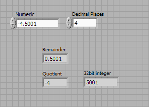

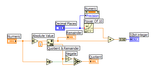

altenbach is correct. The Q&R handles negative numbers in an unexpected way. But this too is easily handled.

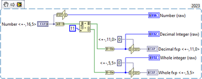

I undestand this is an ancient topic, but for reference, this should be a free implementation
If we're talking pure bitwise split the snippet works.

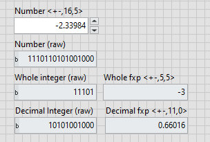

Regarding negative numbers: in the dual complement, negative numbers can be read as "whole part rounded towards -infinity" + (1 - decimal part):
Bitwise split works as intended. Additionally, looking at the split as values: if you add the Whole FXP and Decimal FXP value is equal to FXP value.

Hi blaz,
What's "free" in this implementation?
Why go from FXP to bitarray to integer to FXP?
Sure.
But when working with integers you don't need any bitarrays, use plain boolean operations (AND, OR, shift) instead!
To put it in other words: you only need blue wires!
Edit: added the orange way of getting quotient and remainder…

I meant free as in uses no resources, but your implementation is actually more elegant and should also use no resources (maybe I missed a post).
The back conversion was just to illustrate.

Hi blaz,
This only is valid on LV-FPGA.
In other environments (Win, RT) a bitarray uses way more memory than your underlying FXP datatype (or INT or FLOAT)!
Message 16 of 17
(146 Views)
Correct, I mistakenly assumed the question was in the context of FPGA
(I think I just replied to the incorrect forum post) https://lavag.org/topic/23873-how-to-separate-decimals-and-integers-on-the-fpga-side/
Anyway, your solution is best.
