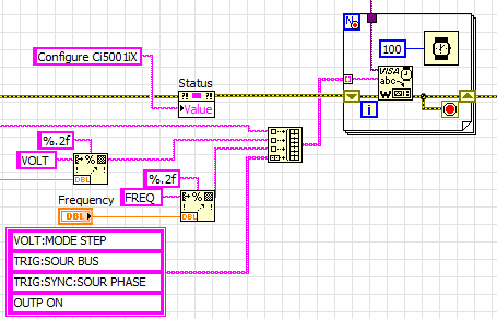

how can send multiple commands to a VISA port?
in the attached drawing you will see a case structure, inside the case sturcture there are 2 commands, I want to send the first command be able to wait a while (delay) and then send the next command.

Try something like this:

Yep, just use Build Array and then VISA Write inside of a FOR loop that uses an Autoindexing Tunnel.  Do this all the time.

Hey RTSLVU,
tnx for the quick reply, can you please explain what do i see in the picture you attached?
like, where do i enter the commands, what does VOLT,FREQ and configure CI500 1ix means?
Those were just the commands for the instrument he was using.  In your case, I would just use a loop to iterate over your delays since the commands are otherwise exactly the same.

Hi crossrulz,
Im new with labview so I would need all the specifics you can give me.
from what I understand you connected the two VISA data wires into the FOR loop, inside the FOR loop there is this object that you are entering a constant string containing the follows:
LR%d
rM
r
what does "r" means?
what is the use for "/"? does it seperate between commands?
also, I want to use labview in order to control the motion of a DC micromotor, the commands I need to send to the motor are as followed:
LR num / num is a value entered by user and tells how much increments the motor rotates
M / begining of motion
delay(#) / wait before sending another command
LR num*(-2) / the motor needs to move twice the distance to the other direction
M / begining of second motion
delay(#) / '' ''
LR num / motor returns to inital position
M / begining of 3rd motion
 I need these commands to be sent one after the other.

@ddwins wrote:
Hi crossrulz,
LR%d\rM\r
tnx
You should look through the self paced training material, but to adress some points:
The is the format string of the Format Into String, if you r-click Format Into String you can select Edit Format string for more information, but in this case it's LE[decimal number][return]M[return]
The decimal number is the wired "i", "\r" = return.
By placing it in a loop, you'll send each row one after another.
/Y
