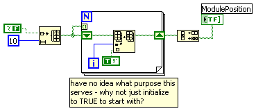

select only even
i have this simply code,
i am trying to select only the odd elements.
i been stuck on this simple code for a while now. can someone give me a pointer on where i can fix this?
i want 1,3,5,7,9

i created this.
but i think there is easy, better ways.

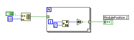

Try using the code below.  You should try to avoid using so many local variables as they slow the code down dramatically.

You really need to learn to program without using local variables and without sequence frames. Your code can be written completely without either one:
As for selecting the odd elements you need to use the other output of the Decimate 1D Array function. Or, are you trying to do this inside the loop, as in replacing the odd elements with TRUE? In that case, use the Quotient & Remainder function.

both methods is better than mine..
yeah..i have alot to learn. i want to setup something
