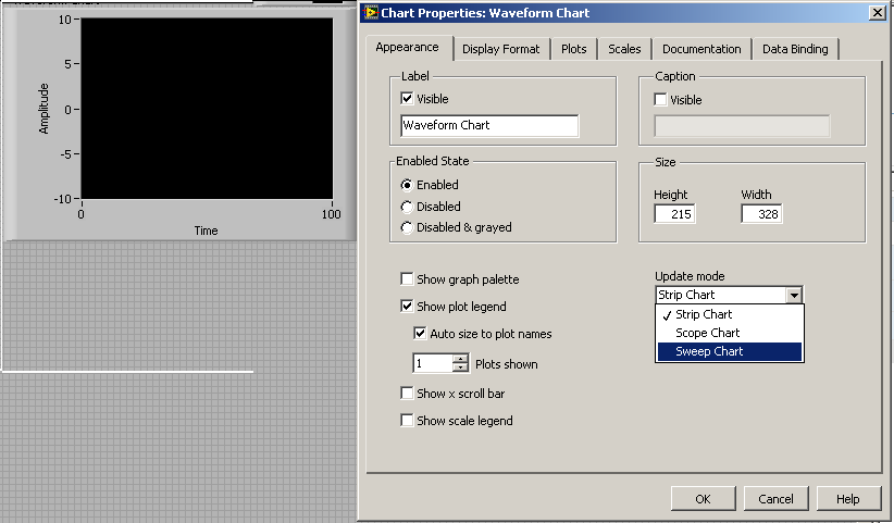

Place waveform chart on the Front panel.  Right click on it and select properties.
Select the Appearance Tab (should be active one) and go to the bottom right corner and select the appropriate update mode.
See image below:

Thank you for replying Joe. That is exactly what I would like to do but I can not find the chart icon on the function menu. This should be trivial. Where is the icon?

Never mind I found. I found the controls pallette.
