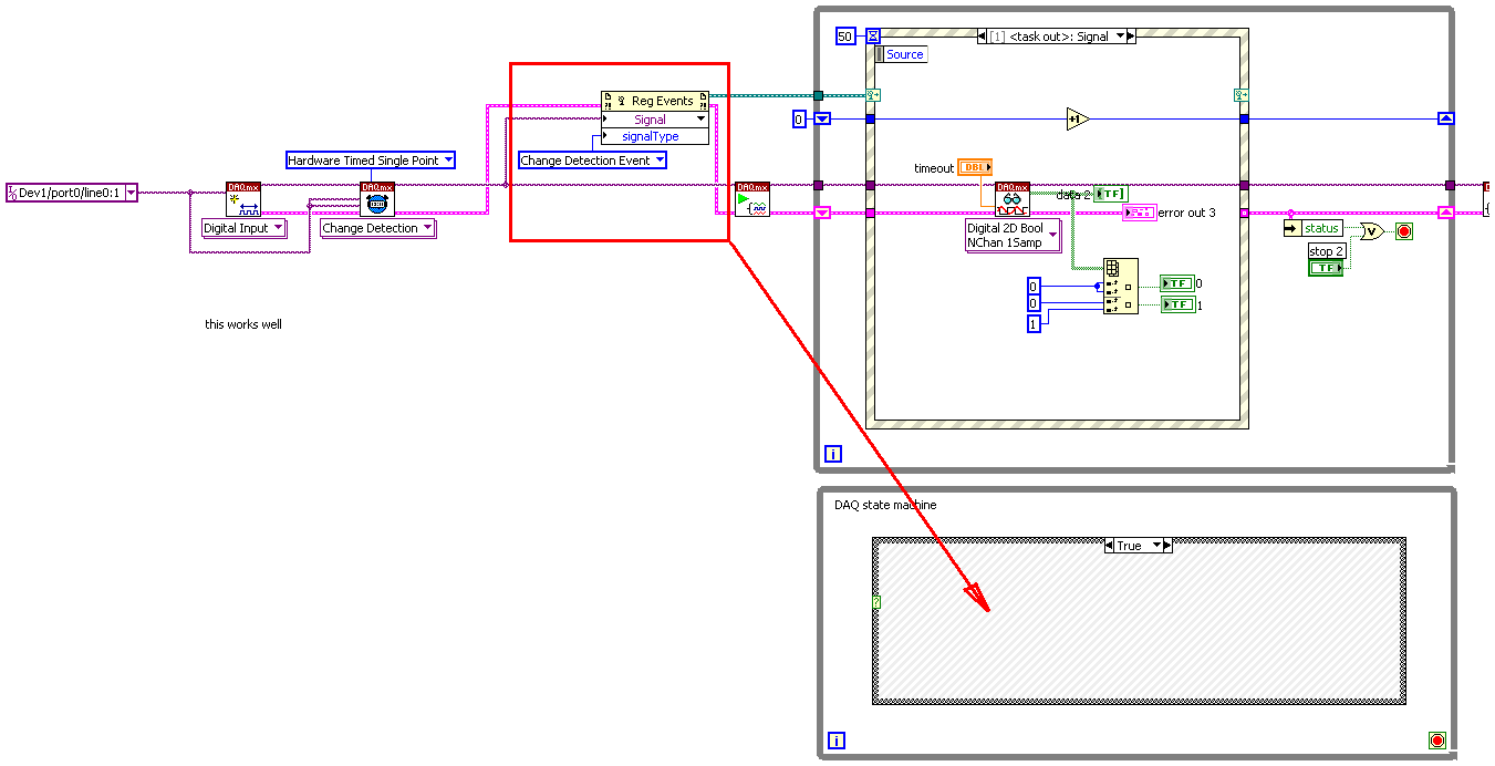

I am fairly green when it comes to dynamic event registration, so my understanding of it is probably quite flawed, but what I have implemented seems to work fine.
Assuming a fairly typical queued producer/consumer state machine architecture.
Up till now, I have done the dynamic event registration outside (i.e. to the left of) the UI loop, so all events get registered before the UI loop starts to run.
My question is:
How can I register events from inside one of the consumer loops? I cannot wire it...
Maybe an example will make my scenario more clear.
I have a DAQ loop (queued state machine). In the init state of this loop I want to register a digital input such that changes on a line are handled by my main event structure (in the totally separate UI loop). Is this possible?
I look forward to hearing positive answers Smiley Tongue

I am sorry, I have lead you astray.
I did not mean to say user events. I was wondering if it is possible to do the dynamic event registration in another loop. See attached crude diagram.
Message Edited by nrp on 04-21-2008 05:53 PM
Ideally I would like all the DAQ stuff to live inside the DAQ state machine loop
Message Edited by nrp on 04-21-2008 05:54 PM

The best way to send data from the Consumer Loop to the Producer Loop is through User Events. What you will want to do is create a User Event whose data type is the registered DAQmx event refnum. Then when you register the DAQmx event in the Consumer Loop, fire the User Event with that new refnum and update the registration in the Producer Loop. That's probably hard to wrap your head around in words, so I'll attach a dummy example and pic below. Hope this helps!
VI Saved in LV85.

Hard to understand in words, hard to understand in pictures! Smiley Surprised
But thanks a lot for your input, gives me something to do tonight instead of washing the dinner dishes...  Smiley Very Happy
I think I need to take a step back and figure out how to properly use user events.
A question though, how did you "make" the DAQmx event ref constant?

I can't argue you on the "Hard to Understand" poing Smiley Tongue
But User Events are very powerful and (I believe) worth learning. I created the DAQmx registered user event ref constant by right clicking the output of the Register Events Node and selecting Create >> Constant. If you change the User Event you're registering in any way, you'll have to recreate the constant, since it doesn't maintain any link to the node after it's created.

Jarrod, the cogs are starting to turn for me now Smiley Happy
This technique seems to get around another problem I had in that if I put several control references into an array, to register them all at the same time to fire off the same event, the event structure would display <?> as the array was not named. I never did figure out how to coerce an array generated using build array into having its own name that the IDE picked up on.
I have thrown together a quick example of what I am trying to accomplish. I suppose for each "group" of controls that I want to have respond with the same event I will need to have a create user event and a register event. I would appreciate you casting your eye over it to spot anything silly.
The next step would be to put all the event constants and create user events into a subVI to tidy things up.
Thanks!
