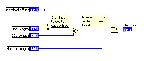

I coded a program that reads a given integer.  The integer represents a character location in another file.  The program then opens a text file.  The program is supposed to goto the integer laction and read 500 characters past that location.  I  am unable to get the program to goto the correct location in the file.  If I give an integer value like 135159, the program goes the location it claims is correct, but it is not.  Are there any constant values that LV uses when reading file locations?  In my file there are 71 characters per line, 70 real characters and 1 line feed.

Well, it's difficult to tell what you are expecting to get, since you didn't tell us, but I wonder if your starting index takes into account the two header lines in the chrom1.p1 file?  The file starts with these two lines:
;Human Chromosome 1
CONTIG-1p1
And then has the list of character codes.  If your offset in your other string is based on the start of data, not the start of the file, then, for this file, you will be 31 bytes off.  If this header is constant, then you can add 31 to your number.  If this header can change, then you'll need to determine its length.
If these files aren't that big, you should load the file, then process it instead of doing constant file I/O to get one byte at a time.
(4,362 Views)
The header stays constant.  The program is supposed to open a text file.  Contained in the text file is the location of the sequence match in chrom1.p1 based on character postion and the length of the match.  The program then calculates the sequence match postion - 500 and the ((sequence match postion+ length) + 500).  The program is the supposed to open chrom1.p1, goto the character postion and count the nucelotides until the program reaches 500.  It does this twice, once for the 500 before and once for the 500 after.  When I run the program for the first match, which begins at character postion 357750  and ends at character postion 358005, I had to add a constant of (5141+(357750-500)+ iteration) to get it to go to the correct location.  For the rest of the matches, using this constant makes them all off.

The problem is your offset doesn't take into account the file header or the end of lines.  So, when you read from file, it includes all those characters.  I wrote a little VI that will calculate the "true offset."  Now, one point of confusion for me is that I had to enter the original spot (in your example 357750) to get what you said is the right point for the -500 spot.  I would have thought I would have to take the 500 into account, as going 500 back also covers line feeds (in this case 7), but if you say that the spot you have is the correct spot, then do this with the desired offset not included.
You can avoid this by reading the file in, stripping the header, and removing all the line feeds.  Your data should be one contiguous stream at that point.  But, you will need to determine if loading the whole file to do this is practical.  With this calculation, you can do it a byte at a time if you wish.
