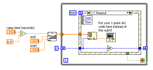

Hi mdstitt,
By implementing the code that Dennis created for you into your VI, you can't use the Auto Indexing feature of the For Loop, as shown in his example. Instead, use the Index Array function connected to an index value that only increases when the Event Loop times out:
Please try out this solution and let us know your results, thanks.

This still will not work. If the ramp VI is outside of the loop, it will never get the values which are generated by another event inside the loop. I also need to automatically generate a new ramp at the beginning of another step, which will have new values for time, begin, and end points. I cannot have any of this functionality outside of my overall loop, but it will not work inside the loop. I think I need to pursue other options for ramping rather than the Ramp VI, or I need to stop programming because I obviously do not know what I am doing!

I don't think you need to give up yet. As I said, you could put the ramp inside the event that generates the values you need and pass the array to another event with a shift register. You could pass the start/stop values via a shift register to the event where you want to do the actual ramping and have ramp VI there. You could pass the start/stop values or the array to a separate while loop with a queue or local variable. The separate while loop would do tha actual ramping. A separate while loop would have the advantage of running in parallel to your main event loop. Your main event loop would continue to run and respond while the secondaray while loop is busy sending out the ramp.
