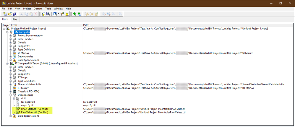

6. After the last conflict is "dealt with," the Project Explorer window will open. If you open the tree at the RT Compact RIO Target -->Dependencies, you'll see the following conflicts, highlighted yellow:
7. Right-click on either conflict and select "Resolve Conflicts..." from the context menu, and you'll get this dialog:
8. At this point, the bug is revealed: Clicking "Use Selected Item" on the copied Type Def shows the dialog flash for a second and revert back to the pre-click display, still showing both Conflicts. Nothing I've tried can get past this.

  1. The conflicts are all TypeDefs
  2. The TypeDefs that caused unresolvable conflicts are used to define Network Shared Variables.
  3. Other TypeDefs exist in the project that do not define NSVs and these did not cause conflicts.
Now, this example has two conflicts that can't be resolved. The project I was working on upon which I first experienced this error with had 58.
Note the LabVIEW Version was 2019 32-bit, (19.0.1f5), and had the Real Time and FPGA modules installed.
