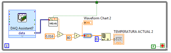

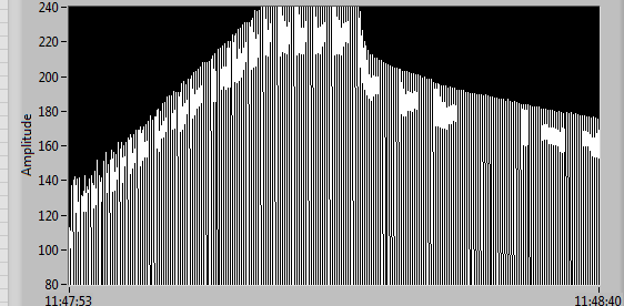

I am using an usb NI 6210 capturing analog singal voltage. It represents Temperature in ºC.
The result that I get is the following:

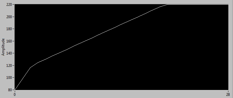

image.pngI would like to doit it without noise, I achieved the following result using the block mean:

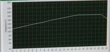

Please, HELP me, my goal is achieve a signal similar to the next picture, but I do not know how to do it:
For additional infomration, I am using this configuration:
Thanks in advance. PLEASE HELP ME.

Taking the mean value is just one simple form for lowpass filtering. Try to use the Filter Express VI configured as a lowpass filter and play with the cut-off frequency and order parameter values.
Unlike the mean.vi that returns one value per loop iteration, the filter will export the same number of samples as it gets in, so you may want to decimate (skip samples) before graphing if that becomes a problem.

You can do something similar to what you are doing and use a point by point mean. That would keep a history of mean values automatically for you and would filter your data. You can play with the history length to get closer to the nice curve that you are looking for.

you should try NOT to mix DDT wires with "standard" functions: there are coercion dots and they have an impact…
Depending on your requirements you already reached that goal!

I am reading this data:
But I want to achieve/filter/process the data to obtain this:
As you see, this second image is cleaner, safetier and "beautiful" for the process.

Yes, I have tried low pass, high pass, and the result is worst than before:
I do not know how to implement this filters in a correct way:
