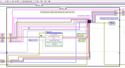

I've inherited a huge block diagram (48x my screen area) and wish to simplify it, so I want to sub-VI chunks of it.
At the lowest nested level, I've bundled/unbundled to reduce in/outs as is required (down to 24 now), and the Create SubVI menu item does nothing; error, no results.
Trying this at higher levels, it says ~"too many terminals" and warns ~"contains Event struct/may change behavior", so I went all the way down to begin at the innermost-nested T/F case struct. The functionality I wish to enclose is selected here:
(It also doesn't work if I select what's *inside* this struct)

Your image shows 24 tunnels on the case structure plus 1 input for the case selector (this would go in the subVI too).
There are also a property node and an invoke node, both linked to a front panel element (image out). And there are two references to front panel elements (Delete Colonies and Add Colonies). These four elements would require a reference input on a subVI. There may be other 'links' to front panel elements in the false case which would require additional reference inputs, but we can't see.
In sum I'm at a minimum of 29 inputs and outputs for placing this code in a subVI. As far as I know 28 is the maximum for a connector pane.
I think you have to put some more elements in a cluster to reduce the number of inputs and outputs.
You could put references for 'image out', 'Delete Colonies' and 'Add Colonies' in a cluster as a starting point.

Hi again, folks. Still having trouble with Create SubVI.
I've bundled it down to 12 terminals including selector. (Yes it should be fewer still, but just going for proof-of-concept here.) I don't think there are enough refs internal to the struct to break the 28 limit. Create SibVI still just hums to itself for a moment, producing neither results nor error message.
Here are both True and False cases, cleaned up (though still ugly I know).
Any ideas as to what might be wrong? (I know modcolonies is quite ugly, but, clean run arrow.)

OK, I have an idea that might give more information or might just be a waste of time.  Follow these instructions:
1. Go to your Options menu and enable VI scripting (if you haven't yet).
2. Have your mega-VI open.
3. Create a new, blank VI.
4. Create a Static VI reference on the blank VI.
5. Insert your mega-VI into the static VI reference (drag and drop the icon on it, or right-click and choose "browse for path"
6. Create a property node from the static VI reference and choose "Block Diagram" (this is only visible if you enabled scripting earlier).  Wire the static VI to the property node input if not already done.
7. Add this VI to your blank VI's block diagram:
<Your LabVIEW directory>\resource\plugins\PopupMenus\edit time panel and diagram\Create SubVI from Selected Wires.llb\CreateSubVIWires_Create SubVI Method.vi
8. Wire the "Diagram" output of the property node to the input of that VI.
9. Create an "error out" indicator from the output of that VI.
10. Go back to your main VI and select exactly what you selected before when choosing "Create SubVI" before when it failed.
11. Make sure to keep that as the selection while you go back to the blank VI that you made.
12. Run the blank VI that you made.
It could take a while or fail instantly.  When it is done failing, check the error out indicator on your blank VI.  If you're "lucky" there might be a failure code and some details as the output in the error out terminal.
Doing all that is basically a way to make the system show you the error it generates when it runs its internal code to make the subVI.  Since we can't see that, intercepting the error in this way is the only way I can think of to try and get more information apart from just trial and error repeatedly.
