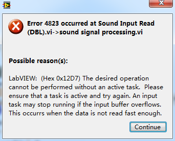

Well, I just want to save the sound signal which was acquired from sound card into a wav file.
I made a VI  (pic 1) but it did not work. The error showed in pic 2, and when I was highlighting it , the error showed in pic 3.

The code looks OK but its really hard to find problems from pictures. BTW, the error in pic 3 tells you exactly why the error occurred. You were reading it too slow (of course, you had highlighting on!).

Hi holidayaa,
The real problem is the your Sound Input Configure .vi is not returning proper task ID and again depends on proper device ID you wire to it.
 Please check the device ID of your card in the device manager and try again.
