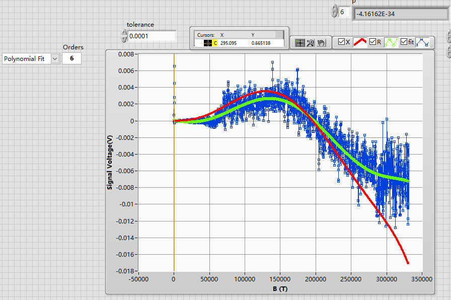

poor polynomial fit with LabVIEW but good with Origin
I am using general polynomial fit function to fit scattered data. But it gives very poor result. However Origin gives good fitting results with the same data and same order(6).
Why?
Attached are the snapshots and VI. Thanks.

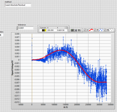

Hi WT,
this is what I get when I run your VI in LV2016:
Very similar to Origin…

Thanks. This is what I get at another computer(LV2013 and LV2019).  I ever got the same result as you sometimes with the same data set. Very strange!
(1,332 Views)
I used MathScript polyfit function (green line). You can seeLV_Polynomial-MS_polyfit.PNG the difference.
(1,322 Views)
It looks like you're accidentally changing your hidden "method" control to "Bisquare". If I change to Bisquare I get this:
With "Least Square" and "Least Absolute Residual", I get the expected fit:
(1,308 Views)

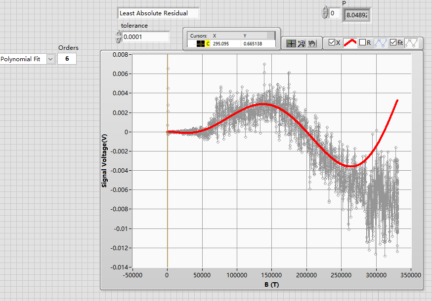

I set the Least Square method and also tried the other two methods.
With the method of Least Absolute Residual, if you run several times, you will get three kind of results.
Something goes wrong with my computer?
Least Absolute Residual1.PNGLeast Absolute Residual2.PNGLeast Absolute Residual3.PNG
(1,294 Views)
Solved.
Except the algorithm of SVD* (default), all other algorithms work well.
