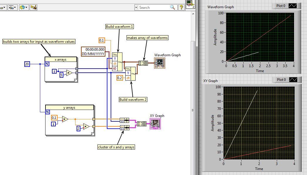

If you plot them as you're collecting them you can use your data arrays to build and update waveforms for each channel and plot them on a waveform graph. Your time increments must be the same for each channel (can't have data collected at random times) but you can have different time increments between the channels.
There's nothing stopping you using this for data imported from excel either. Same conditions as above will still apply. If your data collection time increments were not uniform then you could use an xy plot, as above. You can then input a data array and a time array separately.
