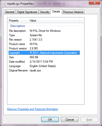

Hi Miguel,
I'm not using Visual Studio but I did try that suggestion anyway and it didn't help.
This was the PAL 2.6.5 update that I mentioned in the original post.
I noticed that the version information for nipalk.sys did not change as a result of running this patch.
Should nipalk.sys version have changed?
Message 6 of 13
(10,320 Views)
Hi grcutter,
The problem described in Visual Studio Projects Referencing National Instruments Drivers May Cause Blue-Screens and File Corr... causes a STOP 0x8E or STOP 0x1000008E error, not STOP 0xC4.
NI-PAL 2.6.5f0 has a file version of 2.1541.3.0 and a date of 2/14/2011, so it sounds like you already have it:
If turning off Driver Verifier's "Security checks" setting doesn't help, please post some information about what NI hardware and drivers you are using.
Brad
Brad Keryan
NI R&D
