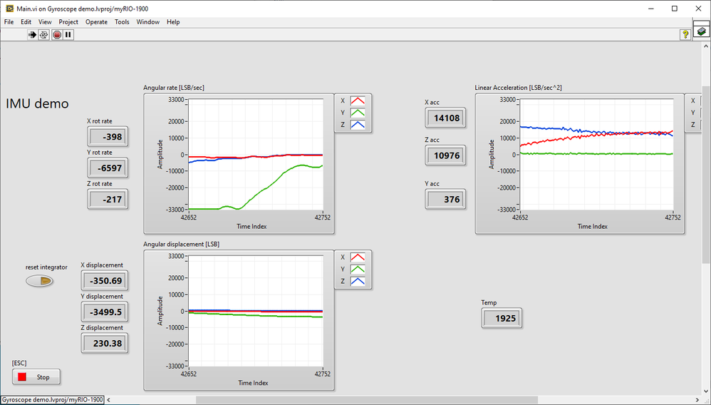

When I run program, it  shows Error -363011 occurred at myRIO v1.0 Wrie I2C.vi.
How to solve this problem?
Use myRIO-1900 and LabVIEW 2018

Save it for LV14 and I will try it on my myRIO with an MPU-9250.

I will read it. Thank you

Accepted by topic author pocket330
Plug and play.  There are a few changes I'd make, but it works right out of the gate for me.  The only modification I made was to remove the logging to a data file which should not make any real difference.
Double check your connections.  I am using the SparkFun breakout for the 9250 which has I2C pullup resistors on-board.

Thank you. I solved this problem.
