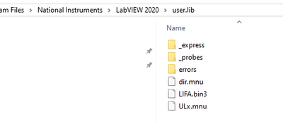

I was able to get it to install properly when I selected only ONE version of LabVIEW during installation.
The mnu file (attached) should be copied to folder user.lib
