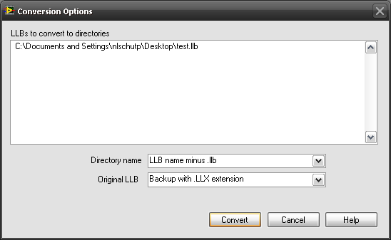

Hello Peter.
First at all, thank you for your answer. Now, I know what is the propuse of the LLB's
I would like to ask you a question, maybe it's very basic...anyway. In your post, you said that I should save the VI's on the harddisk, then, is there any function to take the VI's from the LLB and save them (like the unzip function in winrar) or  do i have to open the LLB, select the VI's and copy them in a folder? Because trying to do the last opcion, there is a pop-up window with a fatal mistake from a cpp file.

Hi 1000a,
Sorry for the delay in answering.
If you want to get the VI's from your LLB, you have to start the LLB Manager from LabVIEW and browse to the LLB file(s).
Than you right click on the LLB file and select convert (see "Select File.PNG").
An Conversion Options window will appear like the one in the file "Conversion Options.PNG".
Here you can make some adjustmens, and after clicking on the "Convert" button, the LLB will be converted to a folder with the VI's.
I hope this will help you with your application!

Thank you Peter S. That was exactly the solution!
