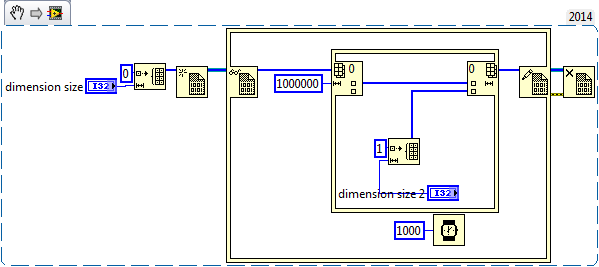

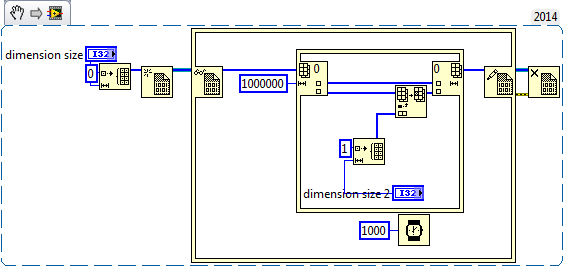

Nathand is correct
Case A is the Best as far memory as code simplicity.
Case B uses the same memory as Case A but mode code.
Case C uses the most memory.
(Note the delay is to monitor the memory usuage on the Windows Task Manager, Should be not more than 3 Mby which is true for A & B)
Case A
Case B
Case C

What about the case with no DVR? I doubt the DVR makes a difference in memory use; it might slightly negatively impact performance because there's an extra level of de-referencing needed to get to the data.
Message 20 of 50
