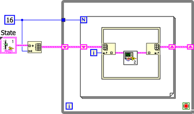

Perhaps maintain the states outside the sub VI.  Like this:

That does seem like a reasonable solution if I'm writing all custom code. It's maybe a bit more work to develop, maintain, but the design flow is clear and I guess it probably uses less memory.
But since I'm (currently) using the built-in PID vi which keeps track of its own state, I'd have to modify it to not track it's own state and instead take state as an input and updated state as an output. This seems like a lot of work.
Are there other pros/cons I'm not thinking of?

Or you could do something like this:
 This opens 16 clones of the sub VI, each retaining its own state.
