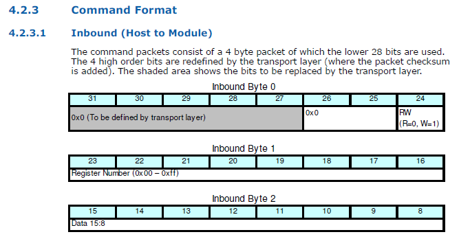

Hi everyone,
I have a new question: How to read the value from a register?
I want to read the value from register 0×41, but I don't know how to do it with VISA read.
this is the command format:
Message 22 of 25
(1,215 Views)
I also notice that in the inbound (host to module) command format, the bit 24 is: R=0,W=1.
If I set R=0 in bit 24, that means I want to read value from some register? but if so, what should I write in bits 15--0?
Message 23 of 25
(1,208 Views)

Row-L: And why is this question NOT placed in the correct forum?
cantata2014:
So agian, what have you tried?
What do you not understand from the protocol?
What does the manual explain about the data field when writing?
