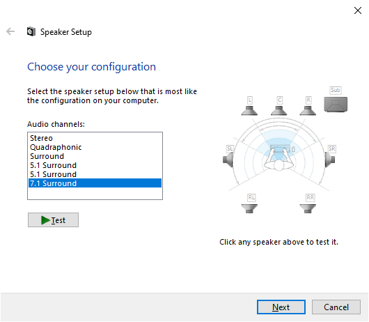

Another thing to check is that the sound device in Windows is configured for 8 channels (a 7.1 speaker configuration):
Some sound cards have the option of configuring the outputs as a single device with multiple channels (1 device with 8 channels), or as multiple devices with 2 channels each (4 devices with 2 channels each). If your card is capable of both options, check that it's configured as a single device with multiple channels.
