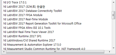

i'am using labview 2017, window7, FPGA 2017, real time module and i install ISE10.1 for labview 2017 sp1
cRIO-9024 controller, cRIO-9114 chassis
i ran FPGA compile and i get this error like blow
i check the package like this
but the licence manager can't show the FPGA 2017 like this
i uninstalled the FPGA 2017 sp1 and install the FPGA 2017 but the system can't recognize
please give me some answer

there is some problem,
1. i uninstall the FPGA sp 2017 and install FPGA 2017 and activate licenses  but the licenses manager don't show the new version
so i'm not sure all the licenses are activated
2. what is compile farm??
is this compile farm?
i installed the ISE 10.1 labview 2017 version and that did not work and i installed the labview 2012 13,4 version but that also
3. few days ago i install the ISE10.1 labview 2015 version. becuase my school have the license.in that day, the compiler tells me "your client is latest" and i install the ISE10.1 labview 2017 sp1 from comparision from site.
i board the my package list please check my progrem
(2,454 Views)
i am running out of hunches. Apparently your software set is ok.
As it is a TCP connection to localhost, maybe firewall? Try disabling it then and test again.
