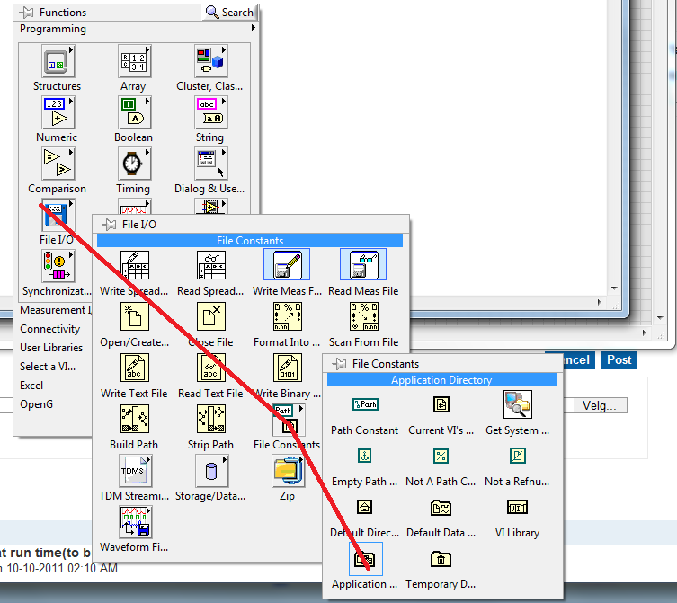

One way to solve this is to include the excel template when you create the installer. So that it will be saved like this:
My program folder
|------------------------->Data folder
|                           |------>Template.xlsx
|My program.exe
In your vi you can use this:
With the application folder node, you can easily build the path to the data folder and the excel template. The node will get the path from where the application is installed on the client computer.
Remember that the template cannot be moved if you choose this strategy.

Hello Saamy,
To create the file path you use the file I/O->File Constant->Current VI Path pallet. So depending on your current file path you can build or strip the path to use the template.
One more thing you have to take care when normally you create a VI If you use these function to finding the path of your template this will work fine, but if you create the EXE the output of the current VI path came different, the output of current VI path in EXE include the application.exe so you have to create path according to your current VI output.
Keep indicator on output path and check in EXE main VI path.

Hi again.
Here is a strategy I always use when I create a project:
Create a folder named for example "My project". In this folder I create new folders called "Bin", "Doc", "Data" and "Img". I put my main Vi in the "Bin" folder and for example the excel template in the "Data" folder.
I then create a project in LabVIEW and I add the "My project" folder into this project as an autopopulating folder. This means if I add a file in i.e the "Bin" folder it will automatically come up in the project.
When I create my Main.vi and want to use the excel template, I simply add a folder path constant to the "Data" folder on my computer. I don't care about the LabVIEW project file.
After I'm done programming and I'm happy with the result I need to prepare the VI for being converted into an .exe file. This means I have to remove all the path constants and add the application folder node mentioned above. I have to know what folder hiearchy I want the installer to create. In this example we can use the folder where the .exe file will be and then a sub-folder named "Data" where the excel template will be. The path will be like "the_folder_where_the_exe_is\data\exceltemplate.xlsx."
When I create the .exe file I can add which files that will always be included. Here I add the Data folder containing the excel template. After that I create an installer where I add the folder where the exe file is, which I just created.
