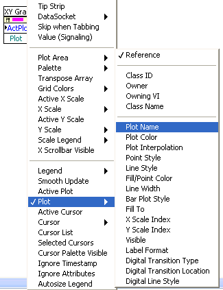

Thanks, that is one of the answers I was looking for. By any chance do you know how to change the name of the plots programmatically. Lets say I have 4 plots, one at -40C, one at 25C, one at 70C and one at 85C. How do you change the names of the plots. I have tried with Invoke nodes but I can get it to work....thanks for your help.
(4,105 Views)
To change the name of plots, use a Property node, set which plot you want to change using the active Plot property, and then set the name using the plot Name property.
