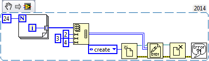

The important question is how the numbers are saved in the file.  Are they strings?  Integers?  Floats?  What size (I32, Sgl, Dbl)?  Is the byte order the same for Matlab and LabVIEW?  Does Matlab prepend size information when it writes the array?
I just did a little demo for myself, since I'd not (yet) worked with 3D arrays in LabVIEW.  I generated 24 integers (from 0 .. 23), made an array with 2 rows, 3 columns, and 4 whatevers, wrote them to a binary file with the default "prepend array size", closed the file, then looked at it.  Here's the code:
Here's what I found.  Everything was 4-byte integers (I32).  The contents were 2, 3, 4, 0, 1, ... 23.  That is, the three dimensions and the 24 values.
Reading works similarly,  Wire an empty I32 array having three dimensions to the Type input of the Read.  You end up with a 2x3x4 matrix containing your numbers.  Note that the first index (which can be 0 or 1, i.e. size 2) has what looks like a 3x4 array, the first being 0..11, the second 12..23.  The arrays have 4 columns and 3 rows (so my description above was wrong).
Very straightforward.

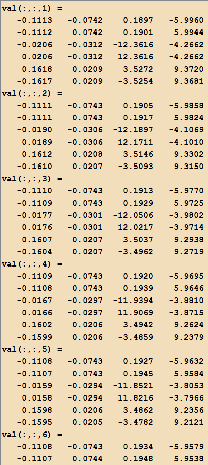

Dear Bob,
Thanks very much for your immediate reply!
I think I did not express my meaning well in last post.
I mean, the 6*4*100 matrix have been obtained in matlab already like this (  only the first five matries have been captured on the figure)
These matries are saved in matlab as the .mat file. But they can also be copied and then saved in txt file.
What I want to do is to input the 100 matries into the time loop in Labview. At each sampling time (5ms), one 6*4 matrix will be input into the time loop for computation. therefore, the time loop will sample together 100 times.
