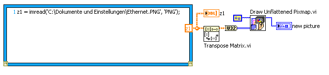

how to use the matlab command imshow in mathscript in labview..it shows command unknown error..is there an alternative command.

Hi BHARATHIN…,
here is in example how you can draw your image if you read it with "imread". But you can also use the "normal" functions to load the picture.
Mike

let me explain in detail..
My application is actually determining the strain in some flexible materials.for that im usin a light marker whose movement is monitored as the body moves.Thus i capture a photograph of initial position ,click on the image of the marker and use the coordinates of the point to draw a frame of reference (a square) around the marker image.as the  body moves the frame has to move.
I thus need coordinates of the point when i click on the marker image of the jpeg file to form the square frame of reference.i have the matlab code to do it but i need to do it in labview

oh thanks.can u pls tell me  how to read mouse position?
Message 9 of 13
(5,351 Views)
Hi BHARATHIN…,
here is a short example.
Hope it helps.
Mike
