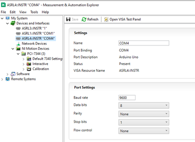

Here I'm also attaching a screen shot which I can see from my NI MAX. COM3 and COM4 are the Arduino Uno connected. But I can't change board ID here. Only option is the "rename"

Sorry for the late reply. I replied a couple days ago via phone but I guess it didn't go through. The device manager is showing the arudino uno from COM3 and COM4 as shown here. But in NI MAX I can't get those two into NI Motion controller. See the attached. I'm struggling on making the device into the NI motion controller as I think this might help me solve the problem.

What you try to do is NOT possible. As far as LabVIEW is concerned, the Arduino is simply a serial device. And as far as NI Motion is concerned it is a brick. NI Motion only works with NI hardware, which has been discontinued a long time ago.
Your PCI-7344 has a last buy date of 9/29/2018 and was one of the last NI motion boards that was discontinued.
Rolf Kalbermatter  My Blog

Thank you for the reply! This is a shock for sure. The PCI-7344 is not a working device but something I created to explore the change board ID option. I'm trying to run a device that someone assembled before but the .vi files are not running properly due to this " illegal board ID". I checked the files that the person shared with me which are NI-Motion configurations. I have 7330. 7350 and 7340. I don't really know any of those.
I think if I can solve this .vi "illegal board ID" issue I'll be able to control the hardware through the arduino. Maybe I'm on the wrong direction? Any other suggestions or guidance are really appreciated!

Unless you have a real NI Motion hardware board, you can NOT use the NI Motion API.
And trying to implement the functionality of the NI Motion hardware through an Arduino is at best tedious and cumbersome, but if you are trying to control real motors and not just some hobby motors with it, it's pretty much impossible.
