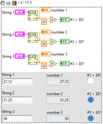

hi everyone i have some question. i want to makes a 3 condition about temperature.
for example when the temperature condition is "less than equal to 30" then the string status "cold", then if the temperature condition is "more than equal to 30" and "less than equal to 100" the string status "normal" and when the temperature condition is "more than equal to 100" then it appears state string "hot". here I use the comparison function "select" how to move to the next case when the current condition is false ? I feel this is the wrong function. I beg your help for the correct use of this case. thank you

You can probably implement this more easily with the Select node (as you've found), but without the Case Structure.
Is this the actual problem, or do you need the Case Structure for more code in the real case?
You're comparing a string to the "30", which probably won't do what you want.
If the pink wire from the left is a string giving the temperature (e.g. "28", "27.4", "95.1") then you can use one of the conversion functions to get a number instead, and then compare to a number. This will compare in the manner that you want.
For example:
By doing a series of different comparisons (here they are all > 30?) you can wire a series of Select nodes into each other and get the string you want out.
Another option is to use Threshold 1D Array, but I often find that function more complicated to understand and have to check the context help (Ctrl+H) every time...

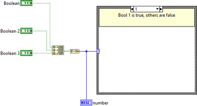

the reason I made it into a case, this string will display the status of the detection and will also display an indicator lamp as well. I think it would be more concise if it was made into a case.

Hmm, then perhaps you can do the same conversion to number, and comparisons to produce a set of booleans.
Then you can build these into an array and use Boolean Array to Number, and then work out the relevant ranges to use in the Case Structure:
