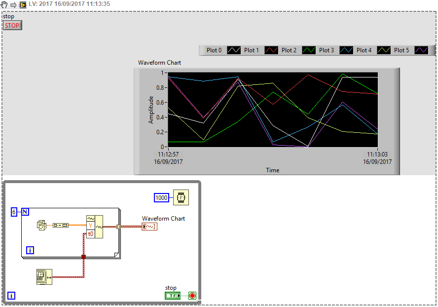

i want system time of x-axis. i can this when using only one graph on each graph chart but in this condition multiple graph on one graph chart.

What you want to do is very easy. Just set the X-axis to absolute time format from the properties menu of the Chart, and use the Build waveform trick to bundle together your data values with time:

i want this graph to be run continuously. graph out put is not as i want. it should show continuous updating input from slider.

  1. Do not mix the terms. You have a Chart here, not a Graph.
  2. It would help if you could explain what is your actual goal:
    1. Your VI just does exactly how you programmed it. Creates a single curve, since you used a Bundle function and a Cluster to Array before the Build Waveform. I did NOT show this way in my example!
    2. Why you want to divide each curve with zero or 1?? If your goal is to hide a curve, just use the Plot Legend, right click on a Plot, and select/deselect "Plot Visible" property!
Check this snippet:
(3,710 Views)
this is exactly what i want.
Thank you brother.
