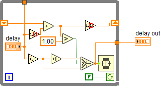

very long time ago I was creating this (should be easy to reproduce, thats why it's only a picture):
This does (almost), what you are asking for, but there are some points to mention:
  • if, for some reason, the calling code doesn't have always the exact same execution time, which you would subtract from the value of the delay input, you will have to handle this changing cycle time too. You could use the "millisecond timer value" output of the "wait (ms)" - function for that.
  • the "Wait Until Next ms Multiple" doesn't help you in this case. It helps you to wait until a certain timestamp (compensating different execution time), but since you are jittering between different wait times, you get new problems. The next picture illustrates this:
The red cells are the ms- times the "Wait Until Next ms Multiple"- function will wait to and altering the wait time will lead to wrong cycle times.
Second complex:
  • can you really show 300 picture frames per second? What hardware do you use for that?
  • Whose eye is able to see the difference between a 25 and 300 framerate?
A good approach to program a video player is to wait in a loop to a certain point of time (e.g. multiples of 40ms), determine the real time (if you jump over one or more multiples, you get back to track) then calculate, which frame is to be shown at this time and load that frame into the frame buffer / picture control. This ensures, that your video has the right speed and will have the predicted play- time.
Greets, Dave
