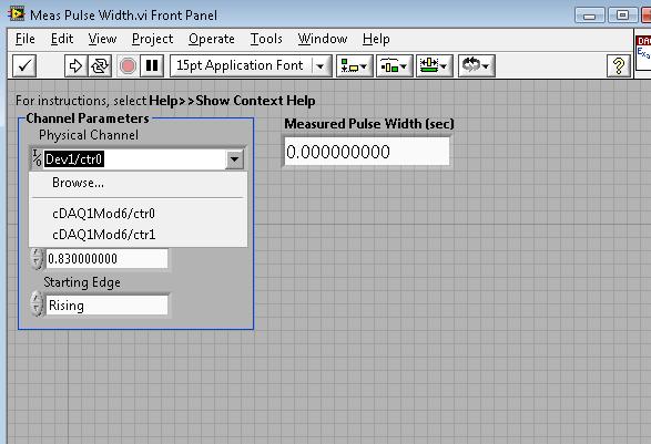

hi,
i have find some examples on how to measure frequency and pulse. I have difficulties in changing the ctr to port/line (I/O). Can teach me how can i modify to fit my application?

Using counter Only You Can Able To Measure The Frequency And Digital Events directly. So Select The Counter 1 and connect the signal to the appropriate terminal.
