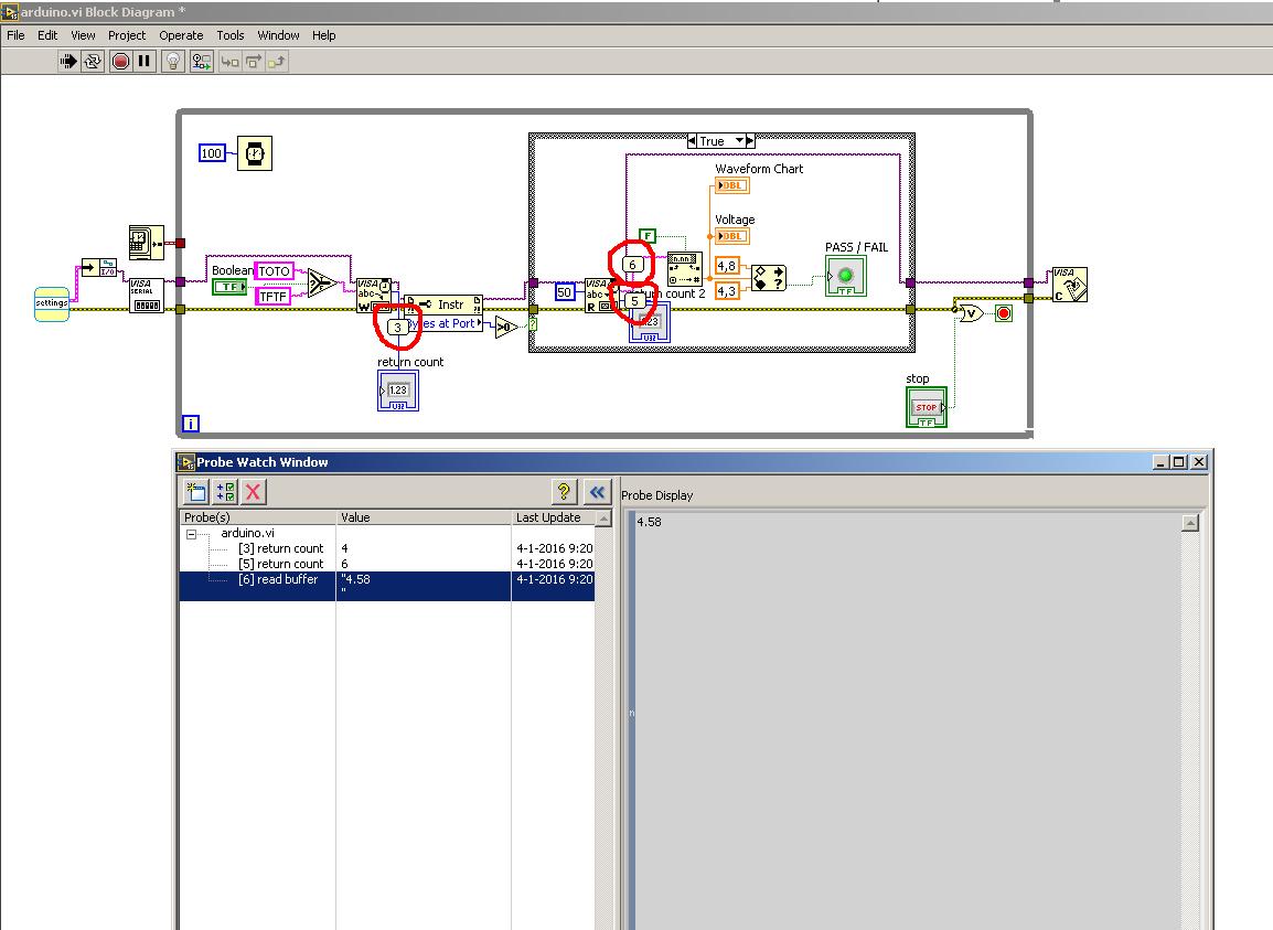

I'm building a device testing tool. And I'm using an arduino to read serial data. I've build a VI but the output of VISA READ is a string witch has a precision of 2 decimals. I need at least 3 decimals. Does anyone have an idea on how to achieve that?

1. Only initialize the port once BEFORE the loop.
2. Do NOT use the Bytes At Port to tell the VISA Read how many bytes to read.  Instead, use a large number (larger than any message you would expect to recieve).  The termination character will stop the VISA Read and return the entire message.
Here is a cleaned up version of your code with a few additional optimizations.

There is no precision associated with a VISA Read. The returned string will be exactly what the instrument sends. Your conversion to a numeric or the display of it does have a precision that you can set. I'm posting from my phone and can't look at your code so I'm guessing you are using one of the conversion functions incorrectly or you don't know how to change the precision of an indicator with a simple right click. The other possibility is that your arduino code is truncating the data. A simple probe on the VISA Read will show exactly what you are receiving.

The Arduino code makes TO or TF (string) a 2 bytes package as far as I can tell. Reading in a longer message doesn't change the lenght that is read in at the VISA WRITE block.
Only thing is that after I changed the code to read in a char or even float its size doesn't increase either.
So truth be told I'm missing something or I do not know how to convert the data as said.

Why do you think that? The probe will tell you the exact string you receive. You don't need to guess. The use of I/O Trace will also tell you the exact string. These are troubleshooting fundamentals you need to do.

The return count of VISA WRITE is depandant on the number of characters used in the strings before it. Both the bytes at port and VISA READ are at 6 bytes. Wich I thought should be enough for a more accurate number.

Hi Teun,
your received string reads "4.58  " - with a linebreak included! So you probably receive something like those chars: "4" "." "5" "8" CR LF !
That are exactly 6 chars and you receive a float with two decimals (after the decimal separator). What else do you expect?
When you want more "precise" floats you need to change your Arduino sketch to actually send them!
(Using a format code like "%.5f" with an appropriate "printf"-command should do the trick…)
