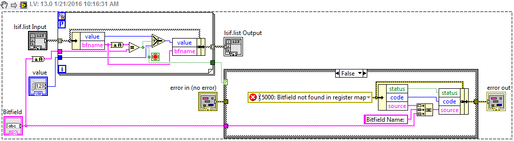

@crossrulz wrote:
After looking at the code a little more, I made this update.
1. Use the FOR loop to do your search.
          You can enable a Conditional Terminal on a FOR loop to abort the loop before it runs through all of the elements.  So you can use that to stop your FOR loop when you found the desired element.  This will actually eliminate the need to build up an array and use the Search 1D Array.  The lack of building an array will help your memory issue some.
2.  Use the In Place Element Structure to index the item you want changed.  Not exactly needed (the LabVIEW compiler does a lot of optimizations), but it makes things a little cleaner.
3.  The Error Ring can allow for inputs for the source.  So you can add a "%s" to the description in the error ring and you will see an extra string input to wire up your search name when it was not found.
A few tweaks to improve performance
LSIF List Regmap Update Value from Bitfield JJB Mod_BD.pngThat Silly case driven by equality is a huge warning!  Just exit the darned loop when you find the Bitfield and the rest of the iterations are unneeded.
For even better performance consider using varient attributes instead of an array of clusters.  Tim, the IPE in this use is not necessary.  The "Magic Pattern" assures the compiler operates in place on that cluster.  The IPE may just slow down the code by adding extra synchronozation barriers.
"Should be" isn't "Is" -Jay

@willholl wrote:
I've found there are lots of VI's that read in files, pass them through the VI attached, then do some functions before writing out.
 How many files are we talking about?  If its one file you should access its data through one Action Engine!
Thus unless I write my VI's with the rigour of C (and I'm not sure how to do that), I'll never get a vi to run indefinitiely and we will always run out of memory at some point.
C and LabVIEW are entirely different.  LabVIEW has a higher level of abstraction than C.  The Memory Manager in LabVIEW does have a tendancy to reserve memory allocations that it feels it might just need again (And this generally increases performance)  Simply Deallocating memory that may be reallocated later should be used ONLY after looking over the code completely.

@willholl wrote:
If anyone can suggest how to find where my issue is (without analysing every VI manually) then that would be great.  There does appear to be the "VI Analyser", but I can't find any tests to add to it, or any documentation on how to write a test, and what it should be testing for, so I'm guessing it's probably not usable in my case.
The default suite of VI Analyzer tests is as likely to find the source of the memory leak as anything.  Additional tests, and documention on how to add new ones can be found here
Slight correction to the previous modified code
Message 16 of 30
(4,061 Views)
The relevant tests in VI Analyzer should be in the BD section. I believe there's a group of performance tests. Specifically, there's one that checks for building arrays and strings in loops. Make sure you go into the options of the tests, because that one, for instance, does not flag Build Array in a loop if it's in a case structure by default. Another thing to watch out for is writing to queues or enqueuing events and not handling them.
The only generic suggestion I have for pinpointing these types of issues is to disable parts of your code until you can pinpoint which part causes the issue. How practical that is highly depends on how your program is built.
