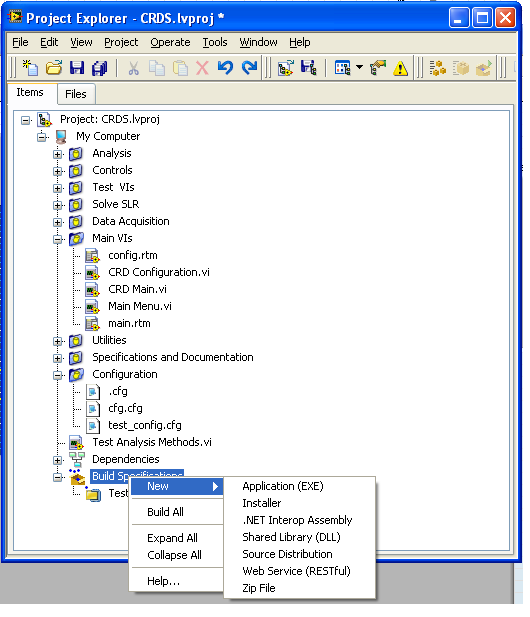

Hey Bebeto,
First you will have to build a project to contain the VI.  Once the VI is located in a project, you can then simply right click on Build Specifications in the project explorer and select new Application (.exe).  You can find more details on this in the Software Engineering with Labview tutorial.  To run this on a computer without Labview, the computer will have to have the Labview runtime engine (which I believe is free).  Cheers, Matt

Hello All,
I have the LabVIEW 8.6.1 Professional Development System
I could not find the option on the Project Explorer to make it EXE as mentioned before.

Right click the build specifications and it will give you the option to biuld an application

Try this:

And for step-by-step instructions, open Help and go to 'stand-alone applications'. You'll see an example and how-to listed.
