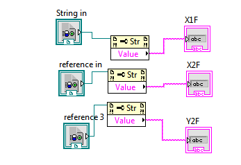

I know that the topic is obsolete but please help me.
I know how to export multiple functions in one Labview dll but it seems that I cannot  get the values from one function in the other. To access these variables I created subVIs which just read these values but when calling these functions in my C code the values do not show. I tried to do that for a constant value and it works, but for shared variables it does not work.
Is there something I am forgetting?
I am trying to obtain the values in the main VI through local variables like this:
and the function (subVI) looks like this:
Message 6 of 9
(4,360 Views)
There are no shared, local, or global variables anywhere in the images you show. All you have are references to front panel items. Rather than trying to get the data through references, create a VI (a functional global variable) that stores the data in one or more shift registers (you could put a cluster of several items in one shift register, or one shift register per value, whatever works for you) that you call from all the VIs in the DLL to retrieve the data.
